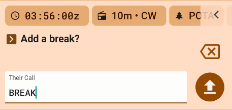

Enter BREAK in the “Their Call” field. If you are in a General Operation, the break will show your current gridsquare as a line break in your QSO list

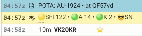

Now change your grid square in the Operation | Location and when you return, the break line will show the new gridsquare.
If you are in an activation operation, change your park or other activation reference(s) and when you return, the break will show the new park or reference ID and gridsquare.

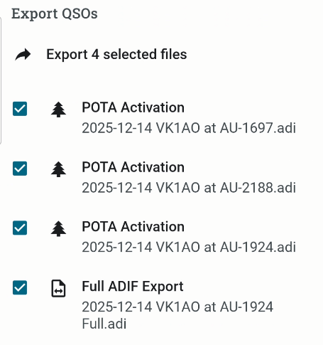

Log exports
Continue on adding contacts until you make another break or go QRT.
When you have finished the operation, the Export list of logs for the Operation will show a log for each break and an overall “full” log for all QSO across the operation.

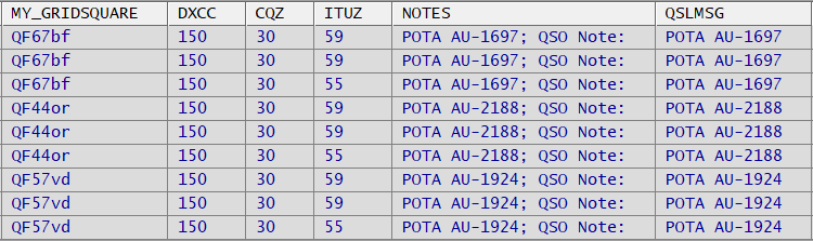

The QSOs in the full log will have the grid location and MY_SIG_INFO fields relevant to each break.
alt text
As usual, the individual logs for each reference can be used to upload to your program admin and the full log can be imported to your log manager in one step.
