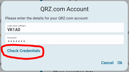

QRZ Authentication
Please remember that logging into QRZ via the API requires that you use your callsign, NOT your email address. You can use either email address or callsign when logging on to your QRZ account, but only your callsign for the api which is required for lookups.
Addtionally, the QRZ API is known to have problems with passwords with some special characters that might work fine when logging thru the web. If you’re having problems using your credentials in PoLo, please consider changing your password to use only letters, numbers and common symbols.
Use the account Check Credentials link to ensure you have the password correct
If a login is successful, this link test will change to a tick

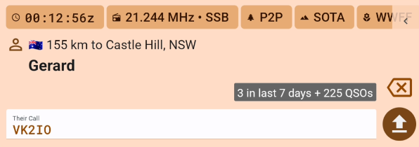

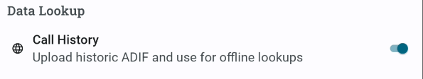

ADIF History
It is also possible to upload an ADIF file to your device to serve as lookup data. In this case, historical lookups are done across all operations plus the ADIF records you have loaded.
alt text
Enabling Call History data lookups will use the historic ADIF data imported under Data Settings for data lookups. It will also enable QSO statistics to be calculated from all data (Operations and Historic ADIF imports) and display summaries when both entering/editing QSOs and displayed on the full callsign lookup panel.
