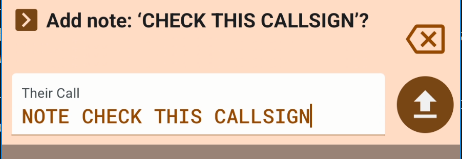

NOTE
alt text
Type NOTE and you will be prompted to keep typing to add a free-form note into your operation.
alt text

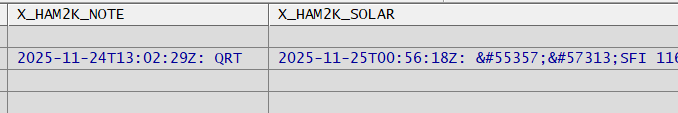

Notes entered in this form are exported as additional ADIF fields in the export file. They contain multibyte characters (HTML encoded emojis). The field names are not part of the ADIF specification and will be ignored by your usual logging program.
alt text

Consuming the PoLo Notes
The PoLo notes, SOLAR, WEATHER, NOTE, START, BREAK are all exported in the ADIF file as the following ADIF fields:
X_HAM2K_SOLAR
X_HAM2K_SOLAR_DATA
X_HAM2K_WEATHER
X_HAM2K_WEATHER_DATA
X_HAM2K_NOTE
X_HAM2K_START
X_HAM2K_BREAK
These fields will be ignored by most applications processing ADIF files but they may be of interest to some application developers.
While the format of SOLAR and WEATHER are as you see them on screen, the format of the SOLAR_DATA and WEATHER_DATA fields which are exported only, is json and can be further parsed.

Shortcut Commands entered in the Callsign Input Field (labelled “Their Call”)
See also Operation Notes and Rove Operations for other entry field commands.
alt text
When you are in the callsign input field, you can use the following shortcuts, always followed by the [Send] key or button on the screen:
  • Enter a band or mode to change the current band or mode. For example 20m or CW.
  • Enter a frequency to change the current frequency (and band). For example 14.070 or 14070.
  • Enter a power level to change the current power level. For example 5W or 100W.
  • Enter a new decimal frequency to change just part of the current frequency. For example, if you are on 14.245 and you type .247, the frequency will change to 14.247.
  • Enter a time or date to change the QSO time. For example 14:30 or 14:30:25 for time, or 05-09 for May 9th.
  • Enter a time difference to change the QSO time. For example, if you are logging a QSO at 14:30 and you type +15m, the time will change to 14:45. If you type -1h, the time will change to 13:30. You can use h for hours, m for minutes, and s for seconds, as well as d for days and w for weeks. See also “Back to Now” in Post Logging below.
  • Enter QRV, QSY, or QRT to self-spot with the respective comment. Enter SPOTME or SPME to self-spot with current frequency and mode but no comments.
  • Change operators with OPER/ or OP/ followed by the new operator’s callsign.
  • Enter KONAMI to enable or disable Developer Mode.
